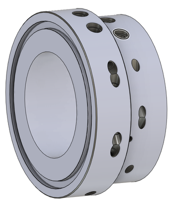

I currently have a tube with a bunch of flats and Holes that I need to machine on a milling machine but I am having trouble defining the Stock in the setup for it. We typically turn it first on the lathe complete and then do milling operations on the mill.  How can I define the stock so it looks like the turning stock exactly?
Would be nice to have a button or a add-in that can make a Spun Profile body that we can use for milling aswell (not just turning).  I currently have to make a sketch on a plane and intersect the body to get the cross-section.  Then I have to edit this sketch to remove the milling features/flats and holes and then revolve it.  Then in setup I select Stock "From Solid"

Message 5 of 10
alex_winter
Here is a Sample Part.  This one doesn't have any flats.
Message 6 of 10
a.laasW8M6T
I copy the body, then use simplify to delete the hole features.
You can drag a slider to adjust what size holes will be removed.
Design history must be on to do this.

alex_winter
We import body's from solidworks (.sldparts) so the part comes into fusion as a single body.   I use to do it this way with 'remove features' but I found it was a bit buggy and you had to be careful what order you remove features in.
These are all good ways.  When I look at the turning spun profile and how it makes it, its just so quick and trouble free.  Kinda wish we could do this with milling.
I have made an add-in that does try to replicate this spun-profile command but it does have some glitches.
