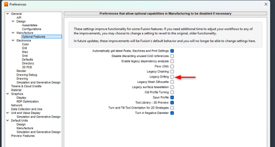

We're aware of the few areas of Drilling time being incorrect and will eventually provide a solution. For now, you could enable to the Legacy Drilling option in your Preferences and you should see the correct behavior (albeit at the loss of using Collision Avoidance)

Yep, that's covered by a couple CAM tickets (one for Reaming, another for Tapping and yet another for regular drilling). Revert to Legacy Drilling and you'll get proper times (it's in Preferences)
