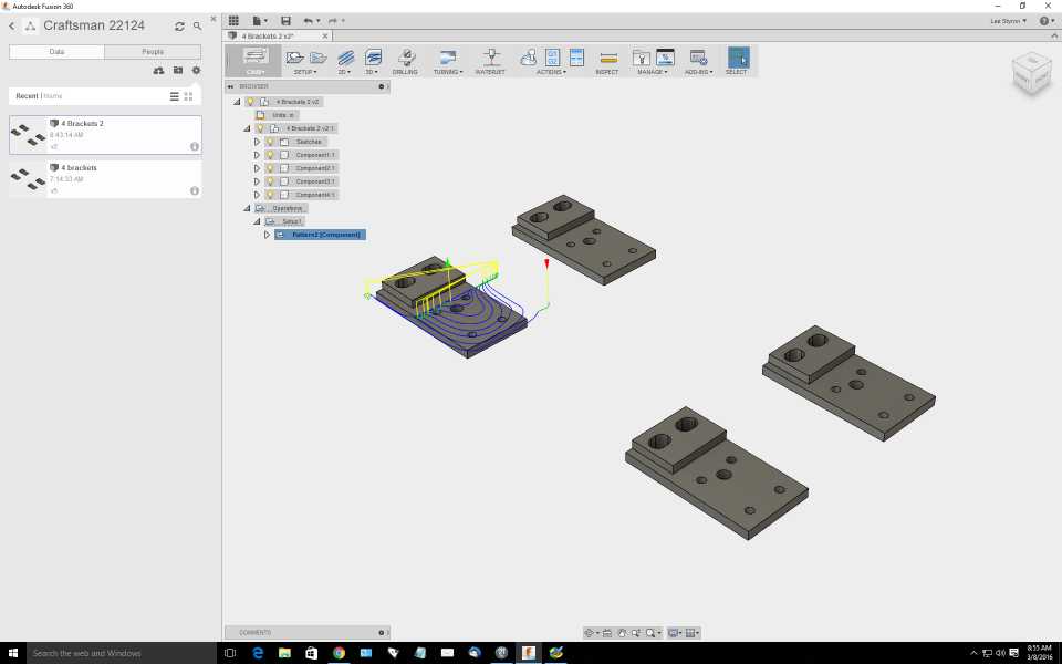

Hi Guys. I know I have seen it somewhere, but I am unable to find the correct way to implement this. I have two double vises on my mill most of the time. They always have the same offsets from each other. At least within our tolerances. I always machine two or four parts at a time. I am stuck on how to machine 4 parts using the same tool on all four parts, then repeating with the next tool. This will get the most out of our tool changes.
I have 4 itterations of a part at the correct offsets now. How do I accomplish this?

I am apparently still having some trouble with this.
I cannot get it to show the tool path on the other three components.
Thoughts?
I have to use the duplicate under the add new pattern command to get it to work.
