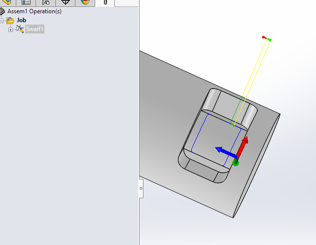

I get an error if i try to POST a wrapped tool path to MACH3 post processor. I have the latest post from cam.autodesk.com. So here is the error message i get.
Indexing with the 4th axis are no problem but wrapping a tool path show this error.
Is there a way to debug post processors?
Vendor url: http://www.machsupport.com
Legal: Copyright (C) 2012-2018 by Autodesk, Inc.
Generated by: Fusion 360 CAM 2.0.4279
Error: Failed to invoke 'onOpen' in the post configuration.
Error: Failed to invoke function 'onOpen'.
Error: Failed to execute configuration.
Stop time: Mon Jul 2 16:04:01 2018
Post processing failed.
Here is the file: https://a360.co/2KGPo5s
An here is the post i use: https://a360.co/2KHPwkW
Hope somebody can help.

I looked into it and when i suppress the swarf operation the post runs. What can i do to get the swarf operation run with mach3 post?

engineguy
@macmanpb
Works OK here if I select an Axis for the job in the Post under program settings. See image attached.
Select Axis to use.JPGRegards
Rob
Message 4 of 9
daniel_lyall
Sometimes the multi axis programs can spit out a tiny B or C move when you do a sim, if turn show axis on it will show the axis moments most times you can spot it there. Or it is what is posted above.

Steinwerks
This is definitely frustrating as I can get a 4-axis toolpath out of HSMWorks, but even in beta mode in F360 with 4-axis Limit on I can't get one to generate or post with any rotary-axis post processor.
@martin.dunschen could you speak to this perhaps?

macmanpb
Hi @engineguy,
in my post i selected the proper "fourth axis mounted along" 😉
Message 7 of 9
macmanpb
Hi  @Steinwerks@martin.dunschen,
I tested the haas, fanuc  and many others but have no chance to get a working post with the swarf operation in
the tested model.
Message 8 of 9
daniel_lyall
Use the Linuxcnc post and turn the A axis on and add in the C axis you will see the micro c axis moves, in the code.
Turning 4th axis limit on stops it working all together.
Sometimes it does work and only puts out A axis moves

daniel_lyall
Just so you know it is not you, this one works and spits out A only, this was used as part of a model that was cut on a 4th axis.
