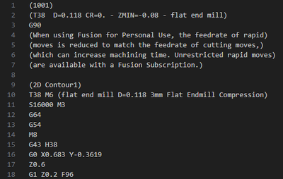

I am wondering how to disable post processor (if there is a fault) or something else so that M6 is not embedded at the beginning of the code?
I don't have an ATC and I manually load the tool into the spindle, set the Z zero, and then run the code. Because of M6 in the code, all the time I have to edit the code and delete it.

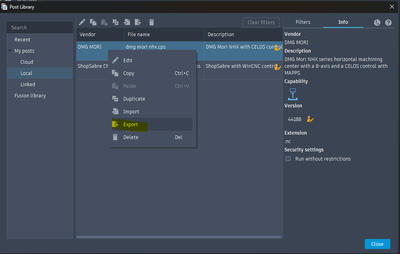

This is pretty easy to do but we need your post processor
can you upload it here?
You can export it from the post library

novaknovak921
Thanks for looking into it.
Here it is.

Hi
Heres the post with M6 removed

novaknovak921
It is working. Perfect. Thanks.
