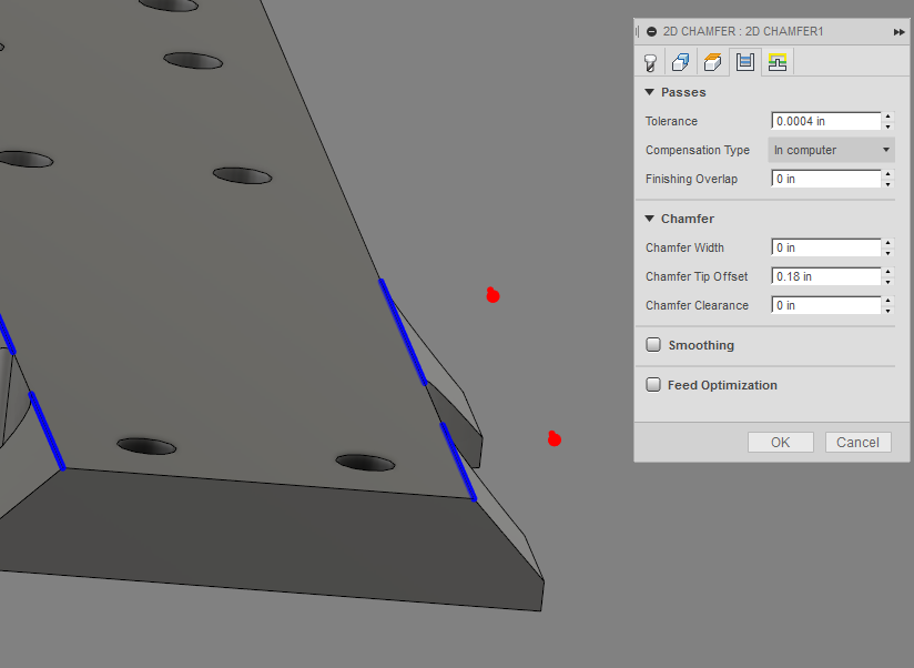

looking for a way to chamfer these edges with a .25 45 deg cutter

Have you tried Chamfer, select the hold the Alt key down while selecting the edges like this.
Then setup like this on the passes tab, 0.18 is the height of the chamfer.
File attached
