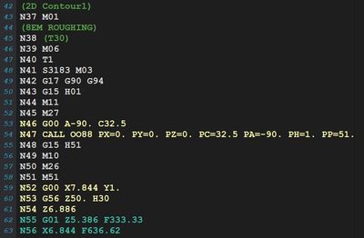

I'm using the standard Okuma mill post for my 5-axis machine. Is there a way to combine the initial positioning of X, Y, A, and C into a single block instead of having them in separate blocks?
I want to have N11 combined in N17
(G00  X53.631  Y-18.553  A30.  C0.)
Thanks !!

g_bergwerf
Hi macr72515SL4L,
Depending on how your control handles it, it might be possible,
Getting it to post on a single line will require some medium difficulty post modification.
Coincidentally I've done it last week so I know its possible to do post-wise.
Are you experienced in post modification?
If you are I'd be willing to explain what I modified, however it is at your own risk.
-Gerrit-Jan

g_bergwerf
Hi macr72515SL4L
I realized I'm actually kind of bad at explaining this kind of stuff so i took the liberty of just modifying the stock post.
It functions like you described for 3+2 operations, I did not change the way code is posted for simultaneous tool-paths.
I'm a fairly novice post-editor so use this post with caution.
I'm pretty confident it will work fine as this is a very similar modification to what I did to my own Haas post last week and that's been running fine.
If someone more experienced can take a look at it and maybe give me some feedback on bad practices I might have, I'd love to learn from it.
-Gerrit-Jan

Hi -Gerrit-Jan,
I tried this modified post, but still showing up the same way. Is there something I need to enable or disable in the Fusion post settings?
Here's the actual codes,
Thanks..

g_bergwerf
It seems like I forgot to mention that you need to enable the post property called something along the lines of ‘simultaneous Index’.
If you enable that it should work.
-Gerrit-Jan
Message 7 of 8
macr72515SL4L
Thanks -Gerrit-Jan! This is exactly what I want the post to do. Thanks for the help. 👍👍
