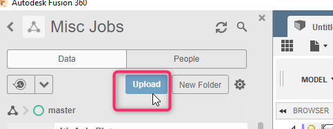

No, you do not need a Team Hub.
Import is simply through the Data Panel.
Go into a Folder you want to upload the file into and select the "Upload" button.
