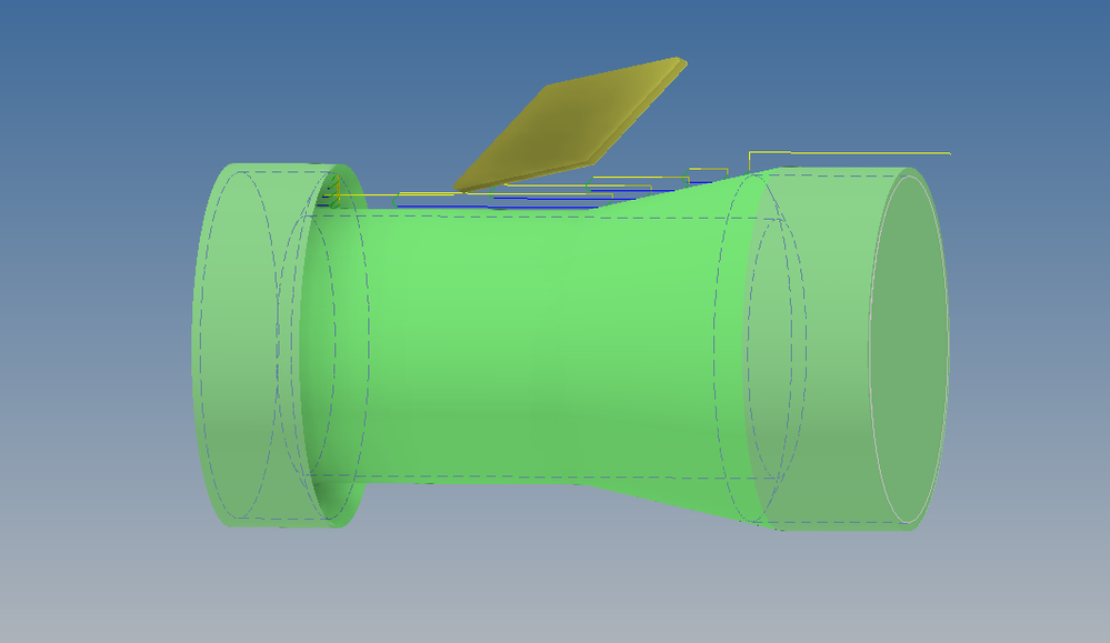

I have a obscured angle in lathe, have any one can help me with this problem.

i used the left hand tool for the rest side but it is not work. thank you so much.

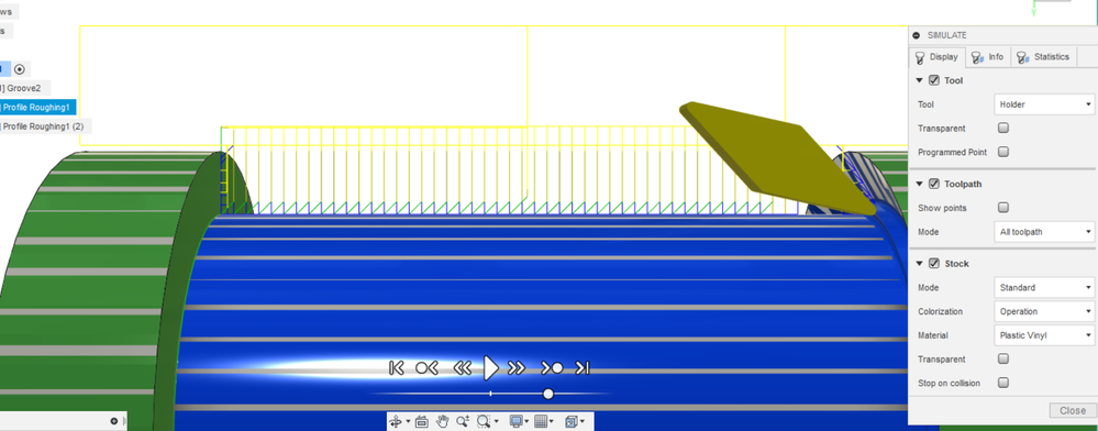

I messed with this for hours trying to figure out what if anything can produce acceptable result so here are few observations.
Roughing using new strategies does not work, using OD turning tool generates crash when strait holder encounters round model.
There is no way possible to modify square holder thickness to provide clearance.
I then used boring bar inverted 180 degrees to substitute for lock of ability to modify OD holder in Fusion.
In either case roughing is not completed, adjusting inner radius height is ignored and at the end of tool path, tool retracts strait up thru the model.
The only way possible is to use multiple finish profiling passes.
Defining insert orientation is not possible without use of holder and it should be, in real world holders are modified for radial clearance and used in a way they were not designed to be used because making face undercuts using profiling tools is very common task.
If insert orientation is tied to holder, user needs to be able to customize holder to any shape that allows creation of tool path.
It is up to user to see that desired result actually matches physical configuration of modified holder.
In multiple finish passes, it only works with "Back to front" cut direction selection which doesn't quite match resulting tool path direction of cut.
Trying to use old roughing strategy produced errors like ..... "multiple contours are not close enough to be joined" and "internal CAM kernel error", I could not produce tool path using model or sketch and error messages don't provide any clue as to what caused them.
My favorite is ..... "Tool path generated successfully in ??? seconds? , followed by ........... "Empty tool path".

i make the same set up on fusion 360 and it worked. i use a custom tool with out holder, orientation is 210deg with left hand and -30 deg with right hand 4.png5.png6.png
