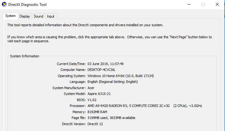

Message 13 of 20
leighCB8FK
See attached photo of graphics card details, its only got 512k memory but is a dedicated graphics card with the latest drivers, plus its a new computer.
Message 14 of 20
daniel_lyall
Hit the check for GPU driver update button sometimes an update will help.
512 is on the limit of what fusion needs 2Gig plus is preferred.
Daniel Lyall
The Big Boss
Mach3 User
Facebook | Twitter | LinkedIn
Message 15 of 20
andrew.colledge
The problem seems to be Direct X 9. We've tried switching Fusion to use Direct X 9 and can reproduce the grey stock in comparison mode. Switching back to Direct X 11 gives the expected colourization.
@leighCB8FK please try installing Direct X 11 and ensuring that Fusion, Preferences, General, Graphics Driver is set to Direct X 11.
Andrew Colledge
Senior Software Engineer
Message 16 of 20
leighCB8FK
Thank you for finding this problem, I've seen it posted a few times, but this is the 1st I've seen about the direct X problem.
I do have DirectX 12 but fusion was set to auto, I've now set to DirectX11.
It's now working.
It does seem to get stuck at times, but I guess that's due to my limited Graphics memory (I'll adjust some setting to try and make it better). but having this working is a massive bonus for me to check my tool paths.
Thank you
Leigh Jones.
