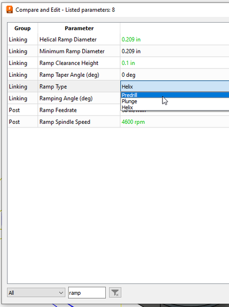

Now, what about having a standard tab setting when selecting 2d contour? And for clearing, I don't want helix to be the default.
Where can I set this?

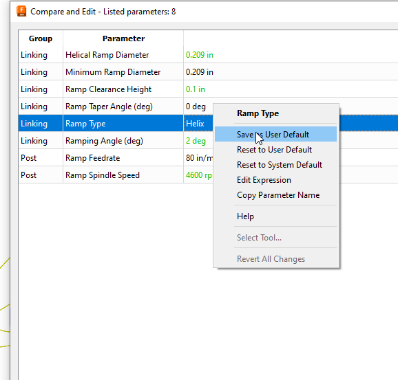

seth.madore
Right click on the toolpath and select "Compare and Edit". This will open a new (large) dialog box with every setting in that toolpath. At the bottom left is a text field where you can type the setting you are looking for. Type in "Tabs" or "Ramp". You can set to what you want and then "right click" and "Save as User Default"
Seth Madore
