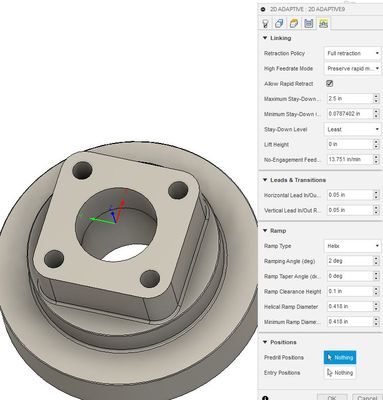

DarthBane55
Like this? (see pic below).
I used 3d adaptive with rest machining from previous operation, and did not select a pre-drill point, it starts in the center when it's a circle.  I removed a bunch of depth of cuts just for picture clarity.

jgaertner
I just set up and ran this 3D adaptive strategy with the center drill and it saved 30 minutes per part! Woo! Whooo!

changedsoul
Did the most recent update break helical entries? Sorry to rant but I need to get something done and I find fusion now selecting things that are not visible, not selecting things that are, and no matter what I do I absolutely cannot get it to helical into a hole. I am so frustrated right now with fusions inability to just do what it should.
I find I spend more time editing tool paths to try and get fusion to do hat it should just do on the first try. Fusion seriously needs to take a look at how these tool paths are being applied, or give the user an option to force things if need be. Rant over.
I need to helical into this bore and it will absolutly not do anything. It either will generate no path at all, or plunge down into the hole and take one pass. I have tried 2D adaptive, 2D Pocket, 2D contour, 3D Adaptive, 3D
Pocket...Nothing works. Its a half inch endmill going into a .9 diam hole.  Can someone lend a hand please?
Message 8 of 10
changedsoul
I feel like a dope! After posting I realized my helical diam was larger than my hole "facepalm". Problem solved. Sorry for the rant.
