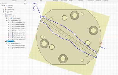

Could you check in my project, is it problem in my case or not!?
Also what command could you advice to create this chanel!?
Message 15 of 15
seth.madore
Yes, that is what is happening in your file. To avoid this graphical display, you would need to create an actual solid model of your stock. We do have work underway to better streamline that process.
To machine that slot, I'd likely use an endmill (smaller than the slot) and use a 2D Contour. The presence of the hole breaking through the slot would likely necessitate an additional sketch line to bridge over that:
