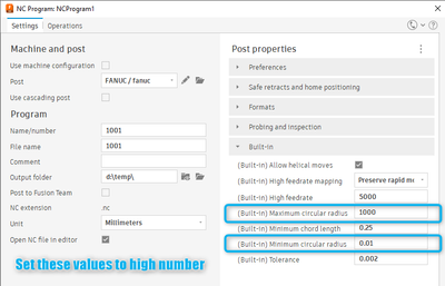

serge.quiblier
Hi @msm19b034
If it's just for one time, and you don't want to edit the post, you can also edit the values filtering the arcs.
If you changes the minimum arc to 6000, and the maximum arc to 7000, it should remove most of the arcs.
As this will define a filter, "I just want to preserve arcs with a radius ranging from 6 to 7 meters"
