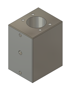

I am using an inexpensive H7 HSS chucking reamer to ream a 14mm hole in 6061 aluminum.  The hole is 1.5 inches deep.  The end result is a cylinder for a model steam engine project (See below).  The pilot hole for will be drilled with a 17/32 HSS drill bit.
I used GWizard to calculate the speeds and feeds of 600 rpm and 2.66 ipm to yield a smooth finish.  GWizard did not indicate a pecking depth.  When I created the tool path in Fusion, Fusion automatically defaulted to "Reaming - Feed Out" for the drilling cycle since I am using a reamer.
Questions:
1.  Do I need a pecking cycle for a chucking reamer?
2.  I have read that the feed rate for a chucking reamer should be faster than that used for the pilot hole.  I planned on first drilling a 1/4 inch pilot hole, then the larger 17/32 pilot hole.  The speeds and feeds for the 17/32 hole was calculated at 1250 rpm and 3.3 ipm with a .25 peck depth.  All feeds and speeds were calculated using the Gwizard calculator.  These figures indicate a SLOWER feed rate for the reamer than the drill.
I welcome your thoughts with respect to verifying the correct speeds and feeds and if I need a pecking cycle for a reamer.  I am using a small 2HP benchtop mill converted to CNC.
Thanks... Richard

No Peck with a reamer you want it Feeding In / Out like you selected, I've found GWizard speeds to be highly variable, what was your Tortise & Hare slider set approx % with 1 being 'Fine' and 100 being 'Rough'

Your problem will likely be swarf build up in the flutes, causing recutting.  I suggest slow and slow.
For best results ream more than one or two test holes.   Make sure reamer flutes are not fully covered by remaining stock after first hole, so swarf can fall out bottom.   Down ward air blast may help

Is this a thru or blind hole? If it's blind, either use a reamer that pulls the chips out (A LH Spiral reamer) or allow for sufficient room beyond the reamer for chips

Thanks Seth.  The hole is a thru hole.  My concern is that the reamer I have is a straight reamer.

I wouldn't worry too much. I just wrapped up a job with a 1.001" reamer, 7.5" deep, also a thru hole. (7075 aluminum)
Slow speed, high feed is the ticket. Oh, and ample coolant if possible.

Interesting.  The reason for this post was that I read that the key is a high feed rate.  I used a feeds and speeds calculator (GWizard) to calculate the speeds and feeds of 600 rpm and 2.66 ipm to yield a smooth finish.   The pilot hole is 17/32.  The reamer is 14mm so there is not a lot of material being removed.  I am using a H7 HSS 5 flute chucking reamer (not a high end reamer) with mist coolant (Fogbuster).   The reamer is a straight flute reamer.
2.66 ipm does not seem like a high feed rate.  What would you recommend?

The GWizard entire range from Rough (100%) to Finish (1%) for a 14mm reamer is
100SFM @ .0089 IPR
90SFM @ .0044 IPR
17/32 to 14mm is about .020" of material removal, which is midrange between the recommended .011" to .028" undersized hole
the Machinist Handbook page on reaming difficulties says .0002" to .0005" feed per tooth which is in line with your speed / feed on a presumably 6 or 8 flute reamer
 Somewhere in there is 'your' answer to your situation but you need to try it and adjust, you have pretty good starting parameters I feel
The feed is mostly to address chip buildup in the hole, and flushing + leaving less material to cut will help, but there are limits
You're about in the middle of these ranges which to me is a green light
