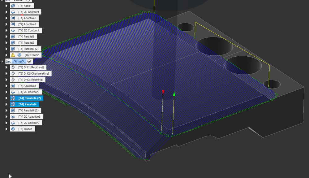

just finishing a relatively complex part here that will be out of 4140PHT. ive got a problem with the finishing toolpath leaving corners not machined.. not to sure what to do about it.. ive fiddled with a few settings and nothing really fixes it from what i can tell..
also if anyone is interested in helping even more, my machine time for this part is probably over 3 hours and thats really just not to good.. i could use help overall just getting the cycle time down faster..Screenshot (5).png

You might find you can use a far courser stepover if you machine the steep areas at 90° like this. Also machine the flat areas with a 2d contour. In the 2d contour op note the use of stock to confine the area machined.
In areas like this I set the bottom height 0.002" above the flat face, you could set less but might get scoring on the flat face.

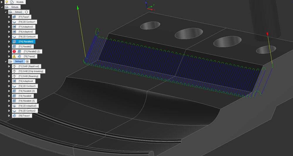

what about in the little pocketed area, that has a .03" radius. i couldnt figure out how to confine my 1/16" ballmill to just cut the radius' so i had to recut the whole little pocket? (the last parrelel tool path on setup 1) any ideas there?
HughesTooling
Sorry missed that. In the attached I've used 2 ops, note the Pass directions are 180° to each other so the machine upto the shoulder.
