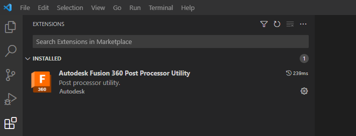

seth.madore
Yep! Download Visual Studio Code and then add the Fusion Post Processor Extension:
You can read more about the use of this addin over here: https://forums.autodesk.com/t5/hsm-post-processor-forum/autodesk-hsm-post-editor-for-visual-studio-c...
