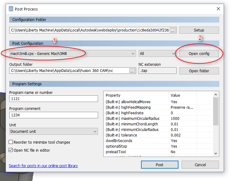

And if i want to edit say the mach3 post, how would i do that?
Message 7 of 9
LibertyMachine
Select the post you want to edit (circled with the #1) and click on "Open Config" (circled with #2)
This will give you the javascript for the mach 3 post processor.
Do note; Do a "Save As" and save the new post to a separate location from the Fusion file structure. Next update will overwrite all generic posts as well as any file stored in that OEM location
