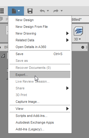

IanRobertson
When I try to export I get as per the screen shot hence my going to A360 as per the help files.

jeff.walters
This is most likely because you have external references in you file (linked part?). You will need to save it out as an f3z file. The link below should help with that. It will be the second part “From the Autodesk 360 Dashboard:”
http://fusion360.autodesk.com/learning/learning.html?guid=kA230000000eDVZ
