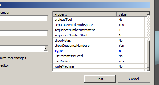

I had a scan through the post and it looks like you need to set the Property type to B or C not sure what else that does but give it a try.

When I change that to B or C I get the following if I post the OP with FPR enabled:

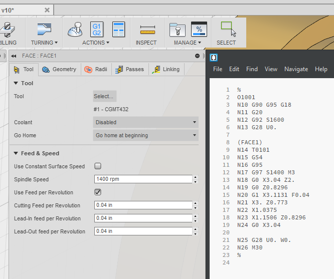

I don't get the same as you, have you set feed per rev in the OP you're using. This is with the FANUC post that comes with Fusion.

I was using the Post that I attached. When I change to the generic post and use type B I get this, which looks correct, right?

I finally got out and tested the code and I get an error before I even start. Mach3 says the line N12 G92 S1600 is wrong, something about all axes missing in G92:
O1001
N10 G90 G95 G18
N11 G20
N12 G92 S1600
N13 G28 U0.
(FACE1)
N14 T0101
N15 G54
N16 G95
N17 G97 S1400 M3
N18 G0 X3.04 Z2.
N19 G0 Z0.8296
N20 G1 X3.1131 F0.04
N21 X3. Z0.773
N22 X1.0375
N23 X1.1506 Z0.8296
N24 G0 X3.04
I think thats coming about from changing to Type B in the post settings.

Fanuc TYPE A is usually G99 for FPR and G98 for FPM.
Type B and C is G95 for FPR and G94 for FPM.
If you use TYPE A into the post you will get G98/99.
