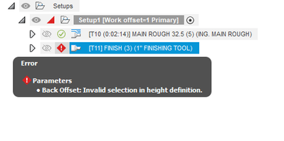

ltomuta
This is a sample turning template I have just created. Really just default parameters for two operations. Yes, you cannot upload template files here (would be nice if we could) but surely that can't possibly stop you. You can upload ZIP files, XML files...
With this basic template the toolpath are safely applied and are generated automatically. So, show us your template.

ltomuta
I was able to apply it instantly to my test project. The toolpaths were generated automatically and really fast but one failed because it depends on a face selection for the back plane.
If you have a design for which this template fails to generate, you should share that too.
