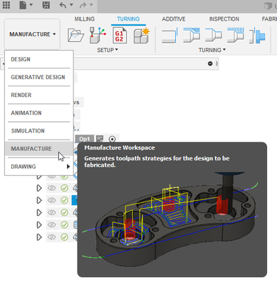

You first select the proper workspace:

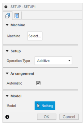

When creating the setup Seth mentioned, you can also select the machine - see image below:
Selecting the machine also defines which manufacturing capability will be used - you can also filter between capabilities on the right - see image below:
If you do not see your machine there, let us know and we can look into adding it in the future.
