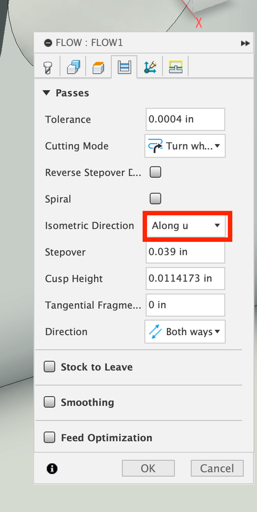

So I have been having tons of trouble getting the new flow toolpath to work correctly . Pictured below is the Old tool path and the new tool path . The old tool path has the nice straight lines that i want . The new one is doing the zig zag tool path .
I typically use the flow tool path for deburring so I just want straight lines . In this instance i have used both Isometric direction selections to no avail .

Flip the iso direction [located in the Passes tab] from "Along u" to "Along v" or vice versa:

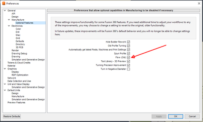

If you're stuck you can reenable the old Flow toolpath or are you just wanting to report the problem?

I am going to do just change the preferences to the old flow path for now . but i am going to report it because its been an issue with about a third of the programs I make . For that reason I am sure some other people are experiencing it as well . Unless i am doing something wrong in the settings.
