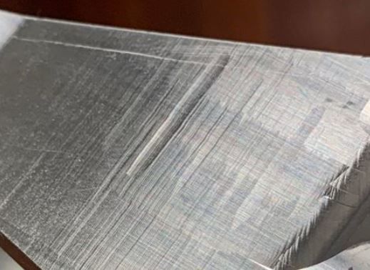

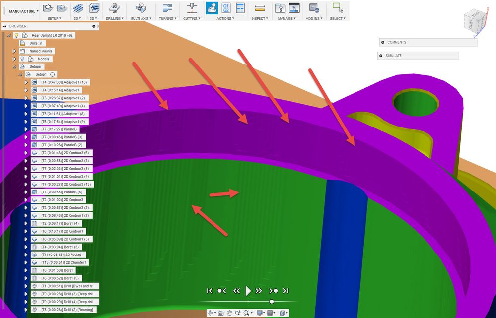

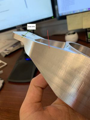

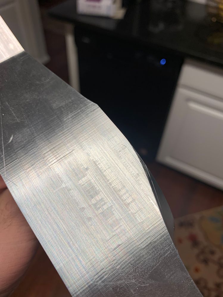

I am running into this issue using 2D contour and 2D Bore mostly. I thought this was maybe an issue with the imported file at first but it is the same on any test part I make directly in fusion. There is gouging/faceting showing up in the bore faces and outer profiles of these family of parts. I have looked through the Smoothing section in the forums and used a variety of different smoothing options for 2D contour (not really anything for 2D Bore) nothing seems to change my simulations which end up showing up in my part. These seem to only happen on circular moves or anything non linear. Can anyone please help me with this!
Machine: Robodrill T14iA (Fanuc 16iM - HPCC (lookahead))
Regards,
Nick

What post processor are you using? When it comes to the Simulation, consider that it's not a very good depiction of what you are actually going to encounter.
From some of your pictures, it looks more like chips are being recut and gouging the faces.

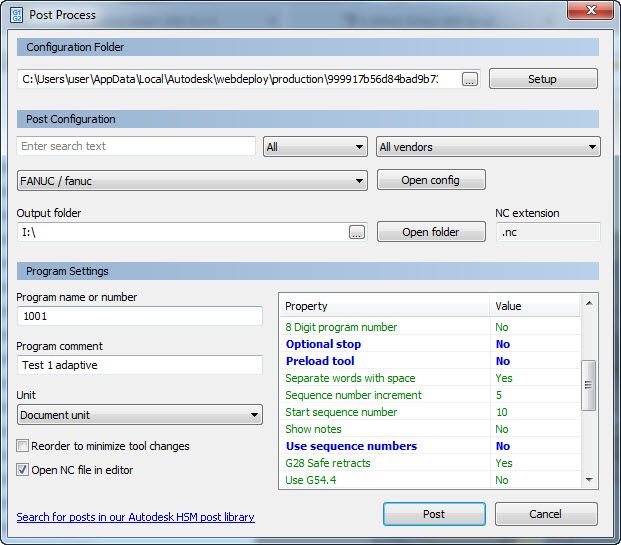

nicknsprecision
@LibertyMachine Thanks for the quick reply mate.
I am in the shop now trying to troubleshoot.
I am using the following:
FANUC Post
"Optional Stop" off
"Preload tool" off
"use sequence numbers" off
I dont think it is chip re-cutting as I have pretty good chip management and coolant hitting the tool. Plus I would think I would have lines/gouging in these other areas (X/Y linear move) if it was that. And i am getting those small horizontal lines in my stock sim in my part which is what led me back to fusion just trying to figure out where this is coming from. This only really happens in combines XandY movements.

Looking at your outside contour rough and finish strategy I notice something that I think may be the cause of your problem or at least contributing factor.
You are leaving .022 radial stock per surface in roughing then finishing in multiple Z levels.
Each time tool bytes into next level, tool gets loaded and causes deflection of part, tool or both, depending on stability, by however small amount, it matters.
I would never do finish cut on turned surface in multiple Z lengths along shaft because result would be leaving steps at each break due to tool load at start of each cut causing deflection and vibration.
I think chips generated on next level are getting wiped around between flutes in arbitrary fashion and time intervals, gouging previously finished surface in upper level.
Tool may deflect as a result of chips interference then spring back and leave gouges in arbitrary places.
I am surprised by the fact that there are no distinctive lines showing each level of finish pass.
I would leave .01 radial stock in roughing, do one pass taking .008 across entire depth and follow with another pass of .002 and slower feed rate.
In this manor you would eliminate any deflection on second pass and establish uniform finish across entire depth of cut, using wear compensation to control size would be good idea too.
I glanced at some other parts and in one case you take 3/8" deep cuts with 1/4" diameter tool, that is a little too aggressive for my taste, if tool leaves inconsistent stock amount, finish pass will be effected by it.

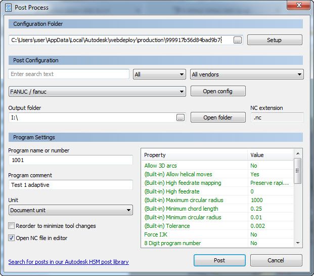

@HughesTooling Thanks for the comprehensive/thorough reply on the boring operation. These are the settings I am using below. Is not using the the IJK messing this up?
I am using HPCC (high precision contour control) adding it in my code using G05 P10000 and G05 P0 to cancel as FANUC told me to do over the phone. It also looks like the post is outputing individual IJK moves? I dont know, I am very new to all this.
as follows:

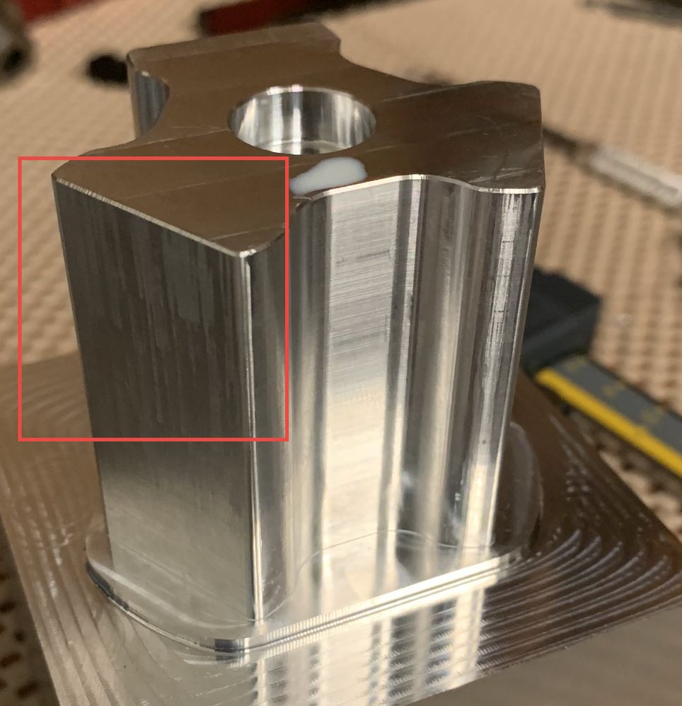

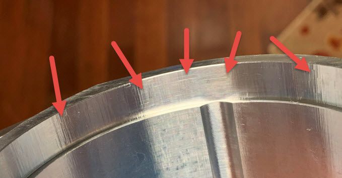

@Anonymous Inital boring op is leaving 0.022" specifically so I can run multiple boring opts for a spring pass at lighter load. (0.002" or less finish pass at a slower feed rate) this is not in the programming tree because I post is separately and use cutter comp. There are no tools 1/4" dia. other than the roughing operation going more than 1x diam. if you look at the 1/4" contouring there is 2 passes with a light pass left at ".150" stepdown. which is not 0.375" that your saying.
For the ourside contour with the relieved 1/2" tool there are gouging in some areas and not if so why would this be?

Another thing that comes to mind is tool run out, are you sure tool is not cutting with just one flute?
It would result in huge feed rate ratio per revolution as well as leaving gap between finish surface and working flute where chips can get trapped and cause problem like deflection and bouncing of tool back into the cut.
Also looking at some of the gouges in pictures, they seem to be taller then depth of cut in each level, leading me to believe that machine is having precision issue in executing tool path in same place on two different Z levels.
All this is just wild guess based on presented and partial information on my end, simple stuff tends to be overlooked sometimes.

@Anonymous wrote:
Also, in anything I do, I,J,K is mandatory in all arc moves, R splits arcs over 90 degrees into quadrants, leaves tool marks and distorts arcs on lathe due to error margin allowance, I believe same is true on mill.
The force IJK is for non modal so you are OK, you're not using R. Looking a the bore code there is no problem there, your post is splitting the arcs into 180° moves and the coordinates are not wandering. You can see I is just swapping positive negative but the same all the way down and every other line matches, J is only output on the first helical move as it doesn't change.
I found a post in another thread where they were using G05 P0 for finishing cuts like 2d contour. Can you try the bore and finish cuts with G05 P0 to see if there's any difference?
Also you might want to download NC Corrector, looking at your finish toolpath from the top shows all levels are identical, You can zoom in real close and there are no signs the toolpath is wandering at all.
