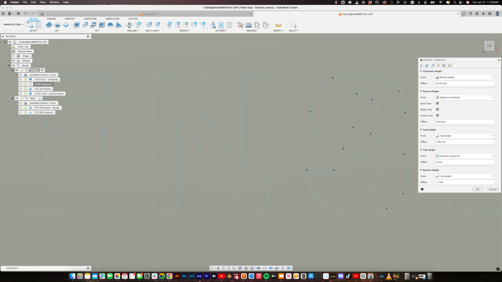

I'm trying to use a 90deg vbit to create an inlay for some text. When I select the sketch profile and simulate the toolpath, the toolpath is offset inwards from the sketch profile whereas I need it to run along the sketch profile. Any ideas on what could be going on?
Screenshot 2025-01-21 at 11.58.38 AM.pngScreenshot 2025-01-21 at 11.59.28 AM.pngScreenshot 2025-01-21 at 11.59.41 AM.png

Check your Bottom Depth and try attaching your file here.
