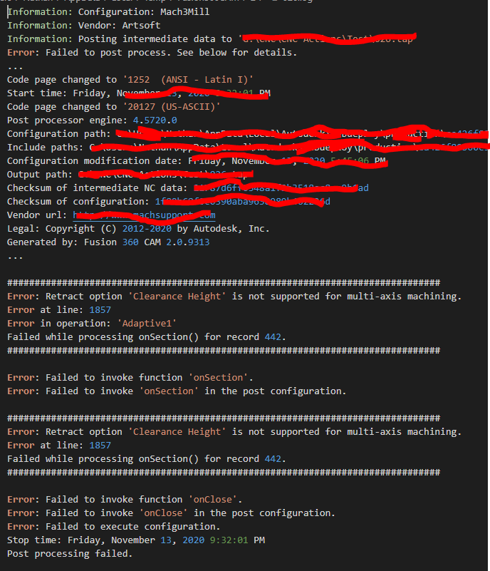

I got an error when I tried to use your Mach3Mill.cps and Trunnio-Test wonder what I'm doing wrong.
Thanks for all your help this far. 😄
Information: Configuration: Mach3Mill
Information: Vendor: Artsoft
Information: Posting intermediate data to 'FileLocation'
Error: Failed to post process. See below for details.
Code page changed to
Start time: Thursday,
Post processor engine: Vertion
Configuration path: Path
Include paths: Path
Configuration modification date: Thursday, November 12, 2020 9:35:21 PM
Output path: FileLocation
Checksum of intermediate NC data:
Checksum of configuration:
Vendor url: http://web.com
Legal: Copyright (C) 2012-2020 by Autodesk, Inc.
Generated by: Fusion 360 CAM 2.0.9313
Error: Retract option 'Clearance Height' is not supported for multi-axis machining.
Error at line: 1816
Error in operation: 'Adaptive1'
Failed while processing onSection() for record 442.
Error: Failed to invoke function 'onSection'.
Error: Failed to invoke 'onSection' in the post configuration.
Error at line: 1816
Error: Failed to invoke function 'onClose'.
Error: Failed to invoke 'onClose' in the post configuration.
Error: Failed to execute configuration.
Stop time: Thursday, November 12, 2020 9:35:49 PM
Post processing failed.

engineguy
@Anonymous
Oops, Doh, sent you the wrong PP, try the attached file and PP 🙂 🙂
Stay Safe
Regards
Rob

engineguy
@Anonymous
Well, all I can say it is working fine here, did you try out the Trunnion Test file using the modified Post Processor I uploaded on my last post, they work here, attached is the G Code as generated here using the Trunnion Test f3d file and the 5 Axis Post Processor, not anything else I can do from here if your machine won`t run the attached code file 😞 😞
Stay Safe
Regards
Rob

engineguy
@Anonymous
You do seem to be making life hard for yourself, you don`t need a Machine Configuration for it to work, I don`t have one in the Trunnion Test file which you should have seen if you checked the Setup in Manufacture, it works fine generating the code. Setup image below.
Have you tried actually loading the G code I sent you into your machine controller ?? Does it load and run without error ??
