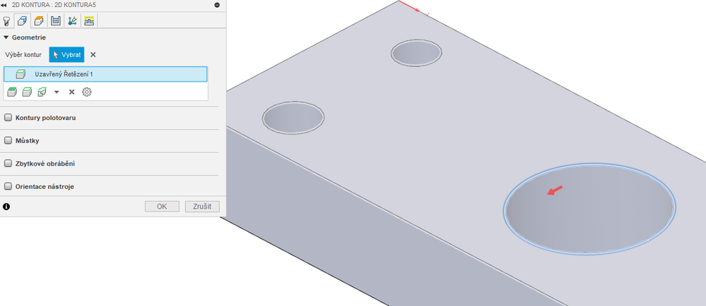

Tomas_V_cz
obrázek_2024-02-14_200321102.pngis there any reason why the hole cannot be selected as a contour?
I mean without pressing the chaining button.
Fusion selects the hole (a new concatenation is created), but the blue arrow does not appear and the edge of the hole does not change color.
If I press the chaining button, everything is fine. But it takes much longer (in the case of multiple holes, I have to constantly repeat the process, it is not possible to select multiple holes. And if so, I don't know how)otvo2.png
Message 9 of 10
programming2C78B
2D contous has no recognization. Try Circular or 2D pocket instead if you have a lot.
You could also select an entire sketch
Please click "Accept Solution" if what I wrote solved your issue!
Message 10 of 10
Tomas_V_cz
Yes, it is possible, but there is a limited operation setting. for example, it is not possible to go down with the plunge feed, set the approach angle, the height panel is also different there (the feed height is missing)... I understand it's for a certain type of operation, but I really don't understand this inconsistent approach in operations.
Sorry for the probably incorrect expressions, but it works in a non-English Fusion environment...
