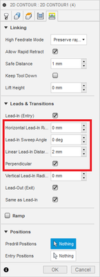

I've been using Fusion 360 for over two years now, and over the last couple of weeks have been fighting what I imagine is a weird bug. When "wear" is enabled, my toolpath won't cut the full contour. It either does a oblong circle or just doesn't fully cut the contour. Any advice would be greatly appreciated. Screenshots attached

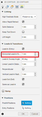

Thanks for feedback. Could please provide a part so I can look at toolpath? We have a bug in Contour2D with enabled compensation and disabled horizontal leads at current moment. It'll be fixed in upcoming updates. It might be the same problem as yours. Could you please try to enable horizontal leads and check if you still have this problem?
Another workaround is using "perpendicular" instead of "90 degrees". It must give the same toolpath.
