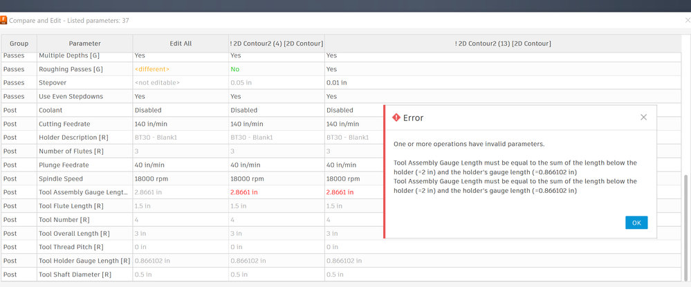

Hi all,
I love the compare and edit function of HSM, but am getting a very strange error when I edit normal parameters:
One or more operations have invalid parameters.
Tool Assembly Gauge Length must be equal to the sum of the length below the holder (=2 in) and the holder's gauge length (=0.866102 in)
The paths post out fine and I can always tweak them one at a time, but it seems to defy the point of this very powerful option. Any insight would be greatly appreciated.

It's not an issue of the post processor (I don't think), but one of the Fusion file itself. Would you be able to share your Fusion file here?
File > Export > Save to local folder, return to thread and attach the .f3d/.f3z file in your reply.

Hi Seth,
I am afraid I cannot share the file here, but it looks like this number was a parameter generated from other tool info.  I updated the extension length, LOC, etc. and now it works fine.
Thanks for having a look.
