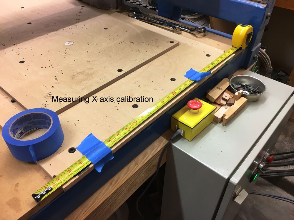

This is puzzling to me... I can scribe a line on my spoilboard, move the Y axis 48" by command line, scribe a line there and it measures exactly 48". I can do the same with X and move 25.75" and the measurement appears perfect. I am using a tape measure because that's all I have for measuring that distance. However, I used 3 different tape measures by 3 different manufacturers and each one measures identically.

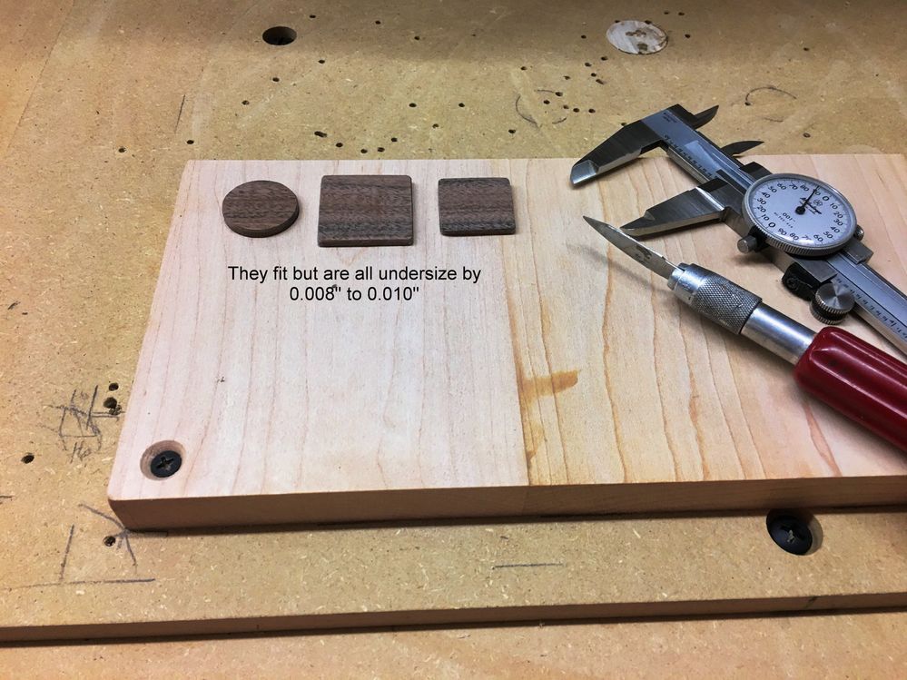

But, and this is a big 'but' to me, if I am cutting a pocket it ends up being undersized. Same with an inlay piece - undersize. I can compensate in the software (Fusion 360) but I shouldn't have to do that. If I cut a 1" square for an inlay piece and specify a 1.006" pocket then the inlay should fit with 0.003" clearance all the way around - it doesn't.
I understand different woods, grain is hard in some areas, soft in others, cutting with the grain, across the grain, etc., but generally a 1.006" pocket should be 1.006", not 0.993". And a square inlay piece that is programmed to be 1" should end up being 1", not 0.992". Also, it's safe to say that all I cut are hardwoods and they hold their dimensions better.
With simple shapes like squares, rectangles, circles, etc. it's easy to make them fit. But when I need to do complex shapes - music notes, arcs, a deer or car - it's very difficult to make these fit and sometimes downright impossible.
When I first calibrated the CNC after I built it I did all my calculations under 6" so that I could use my dial calipers. What I found is that I could get it spot on for a 4" square, for instance, but if I needed to cut something 48" in the Y direction or 25" in the X direction it was off by 1/8" to 3/16" and that's simply unacceptable. So I did it the other way - I made the greatest distances as accurate as I could get them figuring that the smaller dimensions would now be very close if not perfect (within tolerance for the machine, of course).
I have a few projects coming up with multiple inlays in each, probably 20-30 inlays and they're all different shapes and sizes, so I need to get this right. Today I cut some test pieces using a bit that measures 0.123" - a downcut 2-flute spiral - and climb cutting a rough pass leaving 0.005" on the side walls (Stock to leave). Then I followed up with a clean up pass in conventional cut to remove the final 0.005". I figured that should take out any flex issues on the bit and also compensate for different grain directions. The feed rate was 75 ipm so not very fast. I was more concerned about pieces being accurate than being cut fast.
Inlays fit but are undersized -

Measurements of pockets and inlays -

Setup for X axis calibration -
So how can I get these inlays and pockets to be correctly sized? This generally isn't affecting the Longworth chucks I cut so many of and it certainly doesn't affect plaques or signs. But I don't see how it can be right at the greater distances but off on the smaller distances. I also see this when I need to cut a larger hole to fit a dowel, say 1 1/4". If I specify the hole to be 1.260" to give a little clearance then what I find is the hole comes out 1.235" to 1.240".
Is this a Fusion 360 issue?  When I moved the carriage 48" and 25.75" I did it by command line so Fusion 360 wasn't involved.  I suppose I could replicate the 48" and 25.75" test in F360 and see if that works as it should...

Generally whenever someone post this it is their machine. My guess would be that your machine is losing steps as it cuts. When you just jog it the 48" it is under no cutting load which may be why you get your result. If you perform the same but actually cutting with your usual formula and at 75ipm do you get the same result or mis-sized?
Message 3 of 14
difalkner
No, it's not losing steps.  I used the MDI window to move the 48" and 25.75" with a command of G01 F250 Y48.0, so it wasn't a manual jog.  Also, I cut the inserts twice with grain running 90° different on the second cut to rule out grain influence on the cuts.  Each piece came out perfectly cut, except for being slightly undersize, so no lost steps or it would have shown on these pieces.  In the 2+ years since I built the machine it has not lost steps, fwiw.

Ok, found it!!! At least, my tests are now working as designed.  I'll try some more complex shapes later.
Here's what I found - I recall reading somewhere that there's a difference between 2D and 3D Contour in Fusion 360 and that 3D is more a finishing profile.  But 2D works for what I have needed about 99% of the time and that's what I use.  Plus, you can have tabs in 2D but not 3D.  I'm not certain where I read/heard that but I couldn't find this again in a quick search so I'll look later.  Backlash has been discussed amongst the folks I queried on this so I tested that, as well.  It was very minor - 0.001" to 0.002".
Inlay - For the inlay piece I used 2D Contour and my standard climb cut with 0.005" Radial Stock to Leave for the rough pass followed by 2D Contour conventional cut to remove the final 0.005".  The inlays, while slightly off, have not been the issue; the pockets were.
Pocket - I created a profile for 2D Pocket climb cut to clear the inlay pockets with Stock to Leave set to 0.005" Radial. I followed that with a 3D Contour conventional cut and no Stock to Leave plus selected Repeat Finishing Pass to clean up the sidewall.  This makes the cutter go around the sidewall twice, so even if the 0.005" clean-up pass had any deflection the second pass around should take care of that.
The pockets now measure what I have specified in F360, or as close as I am able to measure.  The important thing is that now the inlay pieces fit with no problem.  I even placed my 1" round gauge bar in the 1" pocket and it fit (snug, but it fit).
