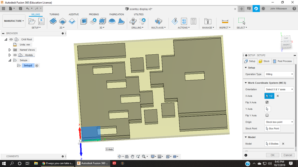

My X-Carve orientation is set for the lower left corner of my mill. i cannot get the setup orientation to match my machine since the latest update. I need the X and Y just like the screenshot but with the Z up instead. i cannot for the life of me get it to work. i went back to check my previous models and the orientations were altered on those as well.Screenshot (1).png

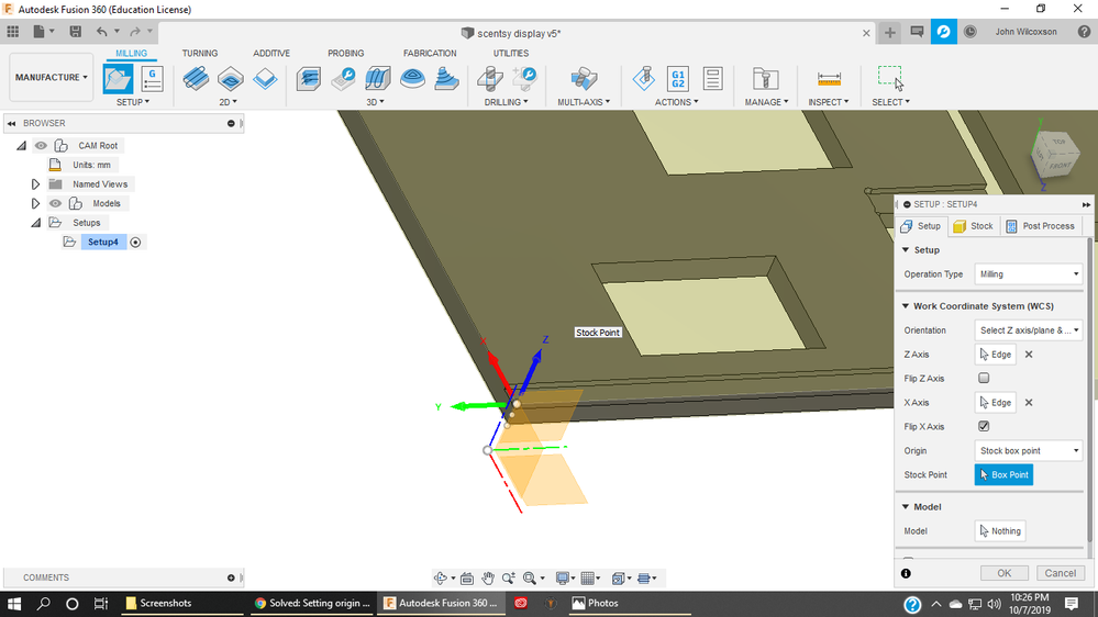

In your setup, select X and Z for orientation. Select vertical edge of model for Z and horizontal edge for X, flipping X axis direction will also flip direction of Y axis.
You can also create sketched lines along origin axis and use them as orientation of X and Z axis in setup.

every time i select flip x, it jumps to another corner. i tried selecting my axis and selecting the point after and the following is the result

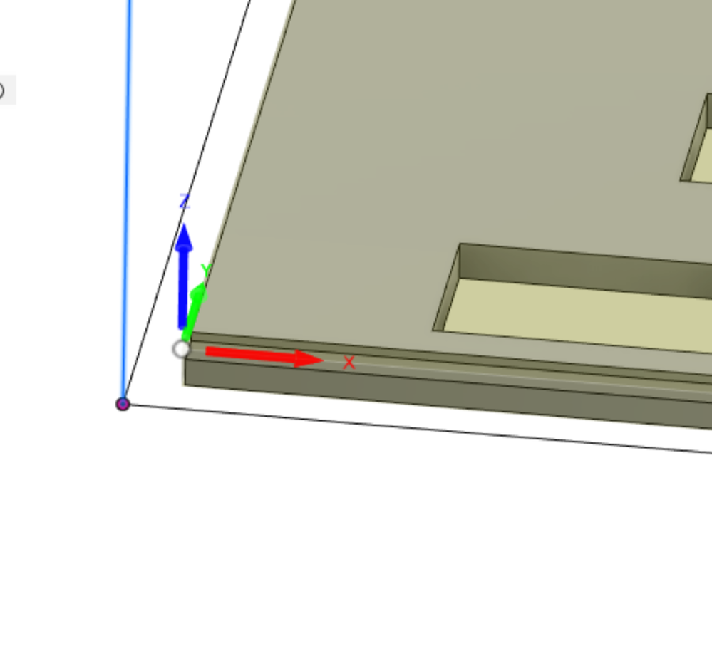

this is what im working with
Message 6 of 8
Is that what you want?

ugh, yes. I'm an idiot, i was trying to reverse the x and y from your picture which i achieved multiple times. now it all makes sense why i couldn't get the end result. thank you for dealing with my foolishness.
