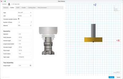

Hi actually I want to build a fly-cutting tool to use for my cam machining the length of the cutter should be long as I need it to reach at least 170 mm below the holder can anyone suggest the dimensions of how can I create in the fusion cam and the cutting dia should be large and the but the shaft dia should be small

Hi @sai_tejaRT58C,
You should be able to use a variety of the available tool definitions to accomplish what you want, you may decide to use one of the following definitions based on how you'd like to use the tool.
A face mill can make the kind of shape you are describing (large cutting diameter, small shaft diameter) and will work with the Face strategy and other 2D (and even some 3D) tool paths.
You can apply a holder (or not) and from your description I think all the necessary parameters should be supported by this tool.
A form mill will allow you to sketch the profile of the tool you want to create, and then store that custom profile in the tool library. However, this type of tool works with a limited number of available strategies, due to its capacity for non-standard shapes. This might not be a big deal for you as it's a fly cutter, but this type of tool is probably also overkill.
If neither of those options work for you let me know and we can take a look at some of the others available.

Hi @martha.deans ,
Thank you for your help! I’ve created a custom tool based on your advice and currently am in the simulation phase. I have attached Image 1 with the tool's dimensions and Image 2 showing the area we need to machine.
I’ve calculated the feeds and speeds using standard formulas, which give me 80 RPM and 8 mm/min feed rate for the 100mm cutting Diameter. However, I have a few concerns:
1. Tool Dimensions Impact : Could the length and diameter of the shaft affect the machining process? If so, how should I account for it in the simulation?
2. Feeds, Depth of Cut, and Time: The current feed and speed result in a total machining time of around 15 hours, which is too long. Is there any way I can increase the feed rate or the depth of cut to reduce this time? The minimum tool length must be maintained to reach the required machining areas.
I’d appreciate it if you could verify whether the tool dimensions are valid and suggest any changes I can make to improve the machining process without compromising on the quality.
