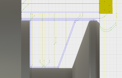

Hi All
So I have a part which needs a large pully grove in it, but on the old machine we would get a lot of metal stringing which got cought up on the spindle.
So I say the pecking option in groving and turned it on, and did as the help suggested and ran the simulation with path points turned on. What did I find ? no points which looked like a peck.
POSTs it out and checked the G-Code and there where no pecks.
So this is a bug right ?
Mike

mjoconr
This is my mine showing it not working
Its late here now, but tomorrow I'll draw something simple and see if it still has a problem
Mike

mjoconr
I just worked out why pecking was not working, if 'Smoothing' on the 'Passes' tab is turned on pecking does not.
mark
I can confirm. Turned smoothing off and now pecking works.
