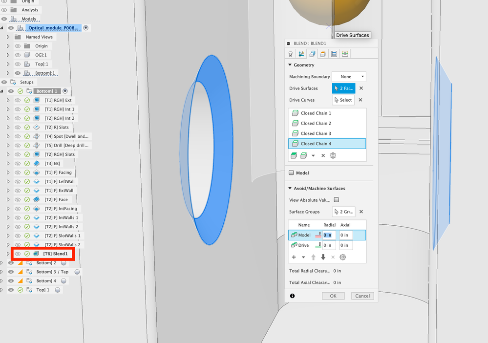

I have 2 perpendicular chamfers that are exactly the same:
Screenshot 2025-03-11 at 11.27.00 AM.pngScreenshot 2025-03-11 at 11.27.04 AM.png
Doesn't matter if I'm using Flow or Blend or what settings I use one always has less stepovers so material gets left over:
Screenshot 2025-03-11 at 11.27.11 AM.pngScreenshot 2025-03-11 at 11.27.24 AM.png
Current Blend settings:
Screenshot 2025-03-11 at 11.30.15 AM.pngScreenshot 2025-03-11 at 11.30.31 AM.pngScreenshot 2025-03-11 at 11.30.35 AM.pngScreenshot 2025-03-11 at 11.30.40 AM.pngScreenshot 2025-03-11 at 11.30.45 AM.png
Adding stock to leave gargles it up with leads that ram into my part that weren't the size I specified. But at least it generates. But then if I don't change anything at all but regenerate it it'll fail lol

Hi @FrodoLoggins
Thank you for feedback. Could you please share the part? Is the issue still reproducable if you machine each chamfer in separate Blend operation?
