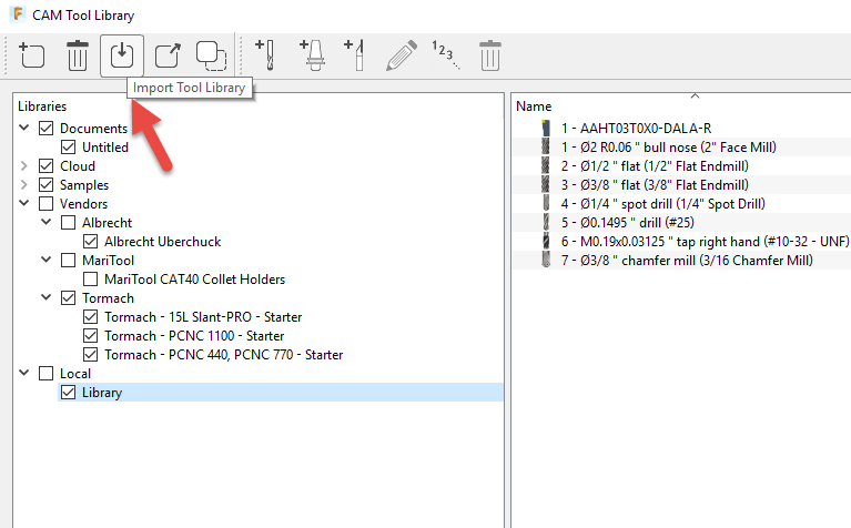

We have found an important issue and would like to get a warning out quickly to help avoid loss of data with your cloud tool libraries.
The team is working hard to correct the issue in a hotfix. This does affect Cloud libraries on both the mac and PC side.
Putting the importance of your tool libraries first, wee recommend in the short term to export your cloud libraries and then import them to a local folder.
The team takes this issue very seriously and will update here with more information on timing for the hotfix.

I can confirm that my cloud library is also gone. It was not located in the trash (which is called "archived" for me) either. I'd be interested to know if the library will be restored? My last archieve is from a few months ago...

Quick update - There is a HOTFIX scheduled for tonight.
This will roll back the .tools format to .Json

Al,
Thanks for the heads up.
I was able to drag my tools from my cloud library to my local library without incident.
After using the Export Library feature all of my tools that I exported were deleted when I went back in!!
I was able to re-import the tools using the "Import Library" function in the CAM Tool Library, but this was disconcerting all the same.

balsmen
Hi Jason,
Yes a fix for this problem was released on Thursday 5/12. Have you updated to the new version of Fusion? If you go to the '?' in the top right corner, and then click about you should see 2.0.2016.
We weren't able to do an auto-migration of your library, so you would have to import the library again.
Have you gone to your trash in A360 Drive and attempted to find the tool library prior to this problem (the one with extension JSON, NOT TOOLS)?
Once you find that library, you should restore it, download it locally to your machine and then use the import button in the Fusion Tool Library Manager.
I would be glad to walk you through these steps via skype if you are still having problems.

AmishSolanki
Awesome! Thank you Noah!!! Was able to get my library back from the trash which is a huge time saver! Cheers again!!
