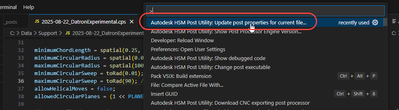

AchimN
@infoXNDBJ
If you are using our Visual Studio Code extension to edit your posts, you will find that it includes a function that makes updating your existing posts with the new property definitions very easy:
I did that for you already using this tool, post attached.
Note that since your post is quite old, you may want to switch to the latest one we have on our library.

infoXNDBJ
thanks, postprocessor properties modernized. It seems to be working now, at least in computer 🐵
