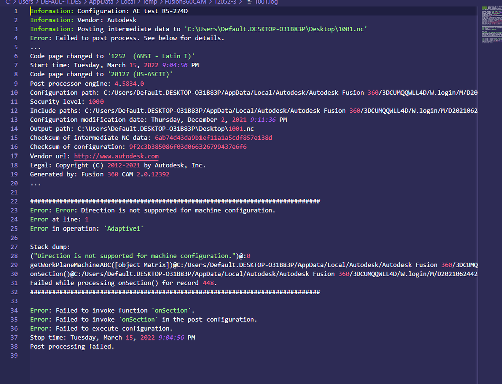

We have a mill/router that has a rotating axis ( C axis that rotates around Y) on the spindle and I'm trying to figure out what I need to do as far as machine setup in fusion as well as post processor tweeks.
On the programing side, I've managed to do a couple of tests with several toolpaths that simulate ok, but I cannot post code with my usual PP. I've included a screenshot of the error I get upon posting.
We are running a no name Chinese 4 axis router that has a Syntec controller. I have been using the RS-274 D post for 3 axis milling so far. From my understanding, this post has 5 axis capabilities but I have not been able to edit the post correctly. Most post edit examples that I have found are based on a different post than what I am using.
I'm also curious to know if there are going to be any changes needed to the machine definitions.
Hoping that there are people out there who have made the jump from 3 axis to 4/5 axis that have been down the same road.

engineguy
@kellyBVJL2
Try the attached Post Processor, it for the Syntec control and should post a C axis rotating around the Y Axis for you.
If it doesn`t work come back and let us know and maybe it can be "tweaked" a little more to get it right. 🙂 🙂 🙂
Does it rotate around the Y axis or does it swing the spindle left/right rotating around the Y axis ? In other words is it the Head that moves and not a 4th axis fixed on the table ??
A photo or a diagram would be helpful 🙂

kellyBVJL2
Thanks! I gave it a shot and it didn't work. I've attached a screenshot of the error messagesyntec post.png

Downloaded the Syntec Manual, slow going getting through it but as far as I can see there is no mention of a G68.2, only a G68 so that may be correct.
Also there is no G53.1 in the G code list so I have stopped that from being output in the code.
Attached is a small Fusion f3d file with some Operations that Simulate correctly and the code generated looks correct also so I will also attach the Post Processor that I have modified and also the .nc code file.
As I have said above, I don`t see any reason why it doesn`t work, maybe I am mising something obvious but for now my apologies this is all I have 😞
Message 17 of 19
engineguy
@kellyBVJL2
I have downloaded the Syntec Manual for Multiaxis operation, for 4 axis operation it says that the Parameters should be set for "Single" spindle rotation and shows the spindle swings left right, this according to the Manual should be either an A or a B axis, a C axis would be a rotating table fixed to the machine bed.
Ihave attached the manual for you, go to page 5 and look at section 1.2..3 Mix Type for the type and page 8 for the Parameter settings.
Attached is the latest attempt at a PP that is set for a B axis.
