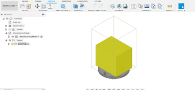

Guten Abend zusammen,
wollte eben mal schnell für den Tevo Tornado im Fusion 360 Slicer zu Druck vorbereiten. Leider fehlen mir nach Auswahl des PP und der Einstellungsdatei jegliche Symbole, wie infill usw., zur weiteren Bearbeitung. Berechnen mit den aktuellen Einstellungen aus meiner Druckdatei lassen sich Problemlos Slicen. Die Symbole zum Verändern fehlen leider komplett. Zum Positionieren sind noch vorhanden.
This is how it looked before Christmas:
This is how it looks now:
the first picture I copied from a video is therefore in English. I can't restore my condition anymore. It's not because of the existing files either. I quickly drew a circle that extruded and created a setup under Make. Here too, unfortunately without success.
Did I miss something with an update or something similar? In advance, THANK YOU for your help.

HI @F19Aurora ,
In the recent Fusion 360 update (which occurred 18th January) we made a change to the way you can edit your print settings.
The additive toolbar will now look something like this:
Previously you had the following 4 extra icons in the toolbar:
1. Print setting selector
2. Print setting editor
3. Infill specific print setting editor
4. Support specific print setting editor
In order to improve the user experience we have simplified the workflow and removed duplicatd steps.

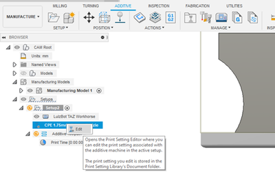

The print settings can now only be selected when creating or editing a setup - see below:
For the print settings editor, this can no be done either within the print settings library (found under the "Manage" toolbar group within the additive toolbar), or by selecting "edit" on the print setting itself within the setup - shown below:
As for the infill and support print settings, they can still be fully edited within this print settings edit dialog as they have always been - see below:
Note, expect to find "Infill pattern" & "Infill Density" in the 'Basic' Tab.

Note you are still able to make permanent changes to print settings, and this can be done via the 'print setting' library.
You can create you own print settings in your local & cloud folder.
See the image below showing this:
