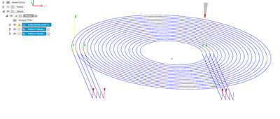

Hi all,
I've been to this forum before (and was helped enormously) but it's been a while and I'm afraid I'm back with some issues on how to generate sensible toolpaths for a new part.  I've provided a link to the file (I think correctly!) that I've started for this crazy thing.  This part requires the use of a 1/32"-dia ball ended end mill, which, please correct me if I'm wrong, but I believe it requires the use of 3D, not 2D, approaches, yes?  I've never yet done any 3D toolpaths, so I'm kind of lost I'm afraid.  I want to define the machining to just do the full depth of the cylindrical grooves 'in one pass', as they're not very deep and I believe the end mill can handle it (this is 6061 aluminum, by the way--).  I'm just not figuring out how to do that, and I'm also having a lousy time of simply defining workable tool paths, at all, for these three 'pieces' of the necessary milling process (that is, the big spiral; the 'entrance' grooves that intersect the spiral, and the 'exit' grooves that intersect the spiral--that's all there is...).  Any and all help here would be greatly appreciated, and I'll learn something valuable in the process, I am sure of that.  Thanks in advance--C. Hale, Lafayette CO

How about a Spiral toolpath and a couple of 2D Contour toolpaths (with Patterns)?
File attached for your review 🙂

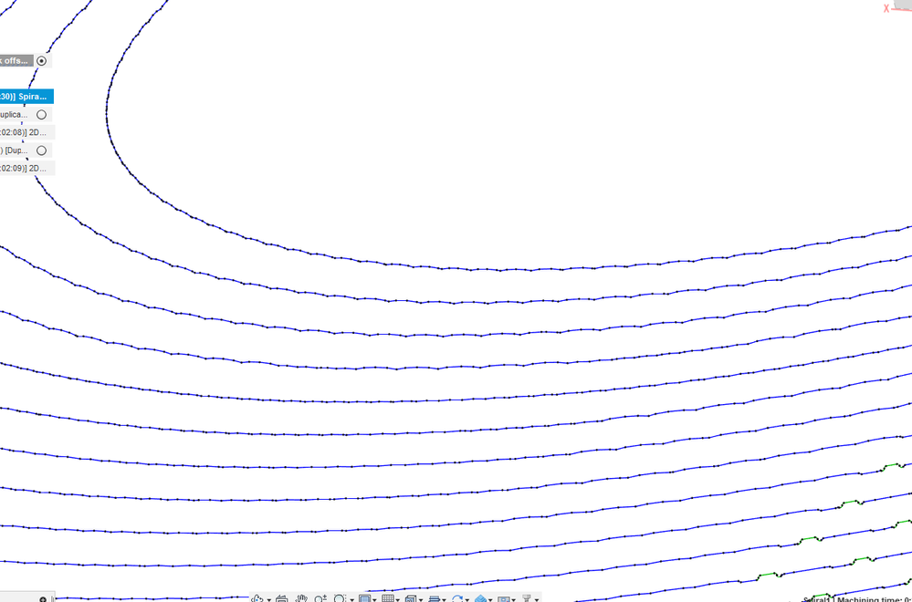

Here's a photo of what I got as described above (F360 CAM, spiral op, 0.0002" tolerance and 0.0002" smoothing, 10k RPM, 6 ipm feedrate, flood coolant; Tormach 770M, carbide 1/32" ball end mill, nearly zero (way sub-thou) TIR using brand new ER-32 collet).  I think there is basically no contribution of the 'scalloping' due to chatter or other machine/tool S&F issues; rather, I'm almost sure it's got to do with F360 CAM settings and/or Tormach770M/PathPilot limitations?  Anyone have any thoughts on how I'd get rid of this 'scalloped' character in the spiral groove?  Thanks--

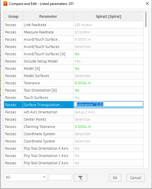

a.laasW8M6T
Hey I had a look at the file and the spiral toolpath was generating pretty rough looking toolpath, smoothing wasn't helping but changing the Surface triangulation tolerance in the compare and edit menu tidied it up pretty good.
Compare and edit is found by right clicking on the toolpath.

Oh wow, ok, so is that ever something I've never heard of, much less knew it existed!  "Compare and edit"--I'll sure have to read up on that.  Thanks much, it sure does appear to clean that behavior up big-time, as you describe.  I noted that the default appeared to be "Surface triangulation tolerance:  tolerance *0.5", as opposed to your change to "*0.02", got it.  Very interesting, to say the least.  I'll definitely try the part again with this setting.  Thanks!!

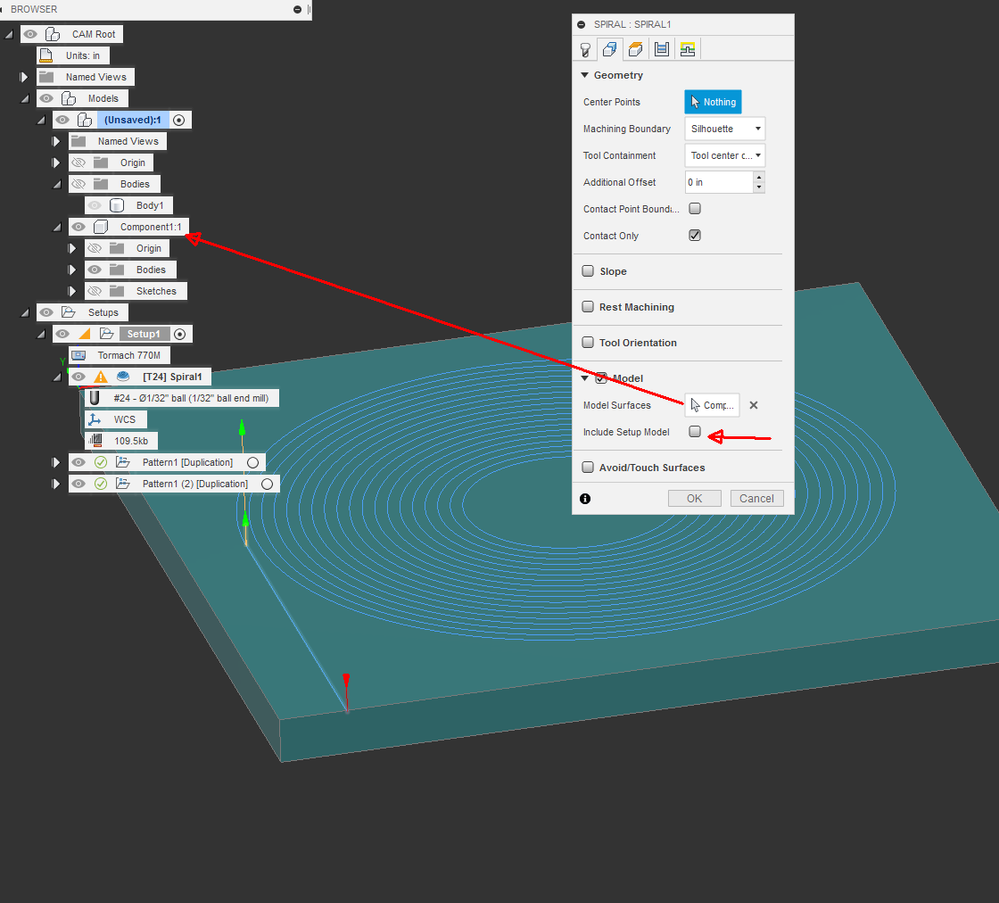

HughesTooling
Here's a way to make sure the spiral is dead flat. Create another body without the spiral, top of this part is a the depth of the spiral. See attached file.
I've selected the new body under Model and unselected the stock model. Like this you don't get all the interference meshing the spiral in the original body.

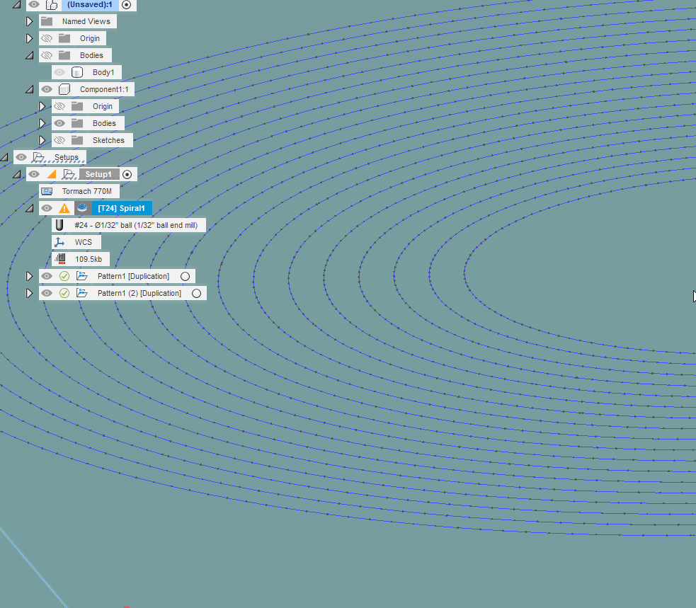

johnhska8
Well, you guys are da-bomb, that is for sure.  The combination of the Surface Triangulation Tolerance tweek, and the addition of a 2nd (yes?) Body that forces the toolpath to stay 'dead flat' in the spiral, resulted in this (see photo attached).  From my perspective it is now 'perfect'.  Thanks you guys--Charley
