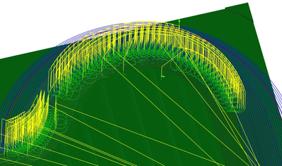

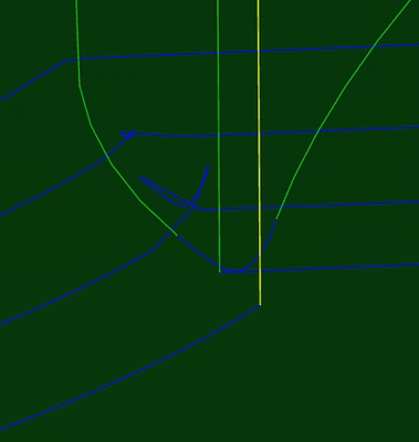

I'm using a ball endmill to add a chamfer to a part that has some oddball angles.  In a couple locations, there are ton of extra wasteful moves, and I'm trying to figure out how to reduce them, as they add a ton of time.
I've added a sample part with a small chunk of my part to demonstrate what I'm trying to do.
Reducing the tolerance obviously helps, but this is a finishing pass, and I'd rather not reduce the tolerance.

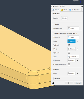

When I open your file all reference selections are lost in the setup and all ops. Can you test your file and fix the selection please?

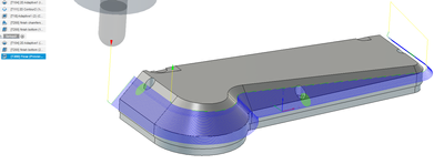

How about a Flow(Preview) toolpath?
Turn on the Flow(Preview) toolpath in your Preferences and select the surfaces you want to machine. Since the holes aren't in yet, you could either make a Patch surface that blocks them up, or duplicate the model and delete the holes

infoEMRZJ
That's super strange.  I don't understand why it's happening, or how to fix it.
I tried downloading the file from my previous post and importing it, updating all of the selections and toolpaths, saving, exporting, then re-importing, and it lost all of that information.
Any ideas?

infoEMRZJ
That does look quite a bit better.
I can't get my flow toolpath to look as nice as yours though, and I'm not sure why.
It gives me a "one or more passes were partially skipped" warning, but doesn't tell me why.
It also does some weird stuff down in that inside radius

seth.madore
It's your Surface Triangulation Tolerance. Right click on the toolpath and select "Compare and Edit". Type in "Triang" and change this to *.05
After that, recalculate your toolpath

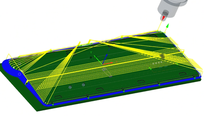

infoEMRZJ
Alright, that helps, thank you.
Unfortunately on the full sized part (I'm not able to share the file with the whole part), this flow toolpath makes a ton of rapid moves, and ends up taking like 25% longer than the 3d contour path
edit:  Is it possible the machine time estimator is incorrect?  It seems odd that this would be slower, looks like the 3d contour path has similar number of rapid moves
