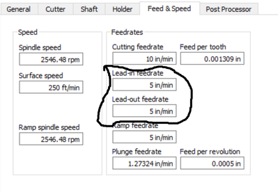

Basically I can not find a solution that allows to change the transition feed rate in a 2D countour. In this case I use 2D contour as rough operation with constant chip load to remove material fast. Operation works great, only thing the short green transition are at the same curring feed rate nad they slam to hard into the material. I would like either change them liek to the "lead in" feed rate or modifiy the angle so that they go at the same speed but with a shallow cut along an angle until to reach the final position to start the circular movement. I have tried ot change all the setting I see but dones't see to do much about it.

You can set it in tool definition but if different, values in operation tab take priority.

That I know. The problem that the transition movements highlighted in the picture are done with cutting feed rate parameter. So lead in and out parameters are not affecting that situation. Maybe is something that Fusion team could add. Like a transition feed rate in the link on GB tab of 2D contour

At this time, it is not possible to change the feedrate of transition moves. That has been requested from time to time, and I think there are some tickets open to explore this, but fairly certain nothing has been worked on at this point.
