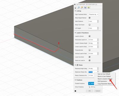

florianhaus
Hi Mark,
here's the file.
Thank you,
Florian

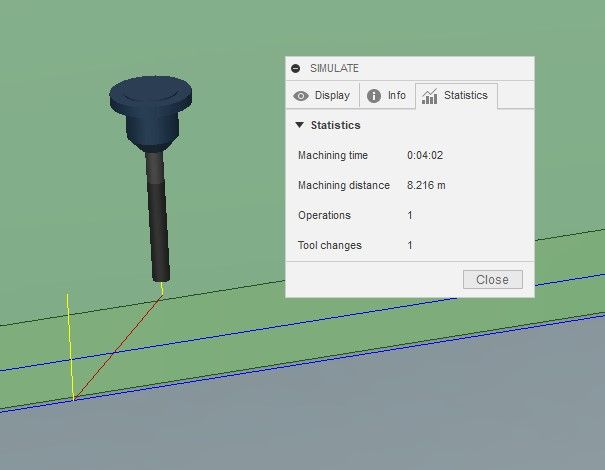

This works here, is this what you are talking about ?? Distance cut is just over 8M which is correct because of the two 45 degree angle ?? Multiple depths of 25mm were used, block is the same as your 1m x 1m x 50mm

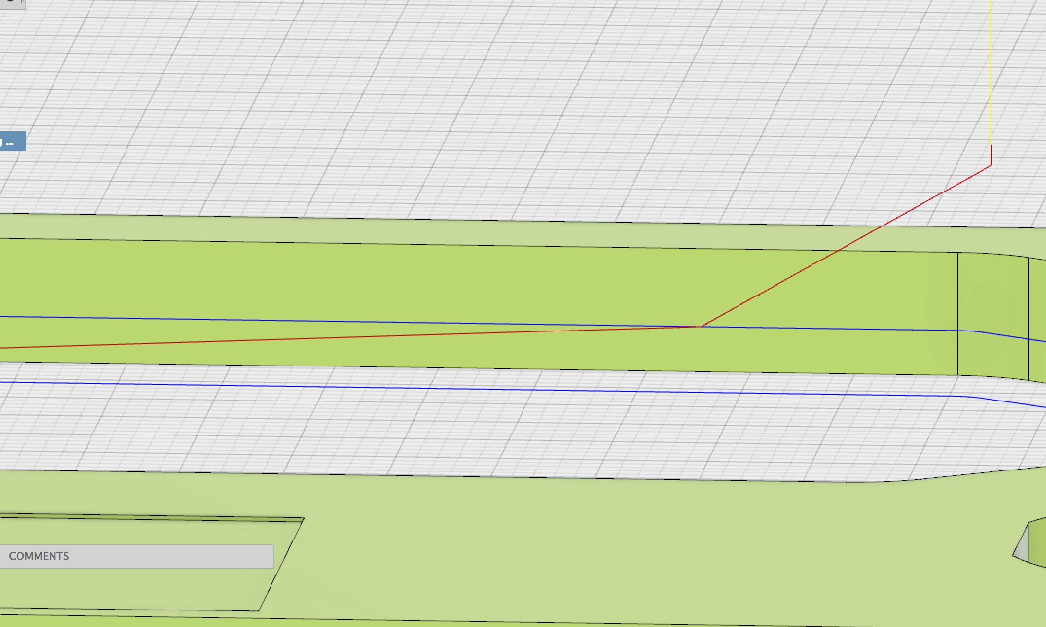

@engineguy  написал (-а):
Yes, it works. But for this you need to change the default settings every time.
Otherwise it looks like this. This topic is about it.
I know how to do it. But why was it impossible to correct the calculation formula so that it would happen automatically?
Newbies do not know this, for 5 years this question has been regularly asked on this forum, and in local groups in our region.
