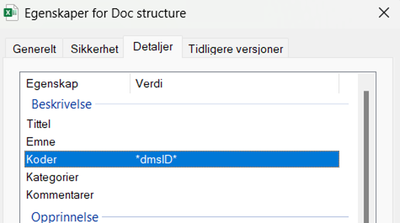

We have created an add-in for Microsoft Office Word and Excel to be able to check in/out files to Fusion 360 Manage directly from Word/Excel. We can also search for items/files from the add-in.
We are looking at improving the workflow and are discussing ways of finding where the file is coming from if a user downloads the file directly from F360M instead of check-out from the Office application.
It would be great if it was possible to read from some property on the downloaded file which item the file is attached to.
So our idea: When a user uploads or downloads files (attachments) to Fusion 360 Manage, F360M should give the file a property containing dmsID, URN, URL, or item descriptor - or any other property making it possible to find the specific item via the API.
Example:
dmsID written to Details -> Code
