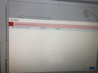

I have listed below some of the key issues I am facing.
  • Drawings are taking 2 mins to open. I have 300 drawings to update to the latest model, review and save. That will involve nearly 10 hours of waiting time !!
  • After updating the drawing, If you open the same drawing again, DWG number is missing from the drawing.
  • When you try to quick release the drawing to pre-production, it takes a further 2 to 3 mins, if you are lucky, or in most cases, you get the error below, which prevents you from changing the model state.
My Observations.
  • Connection between Fusion 360 and managed extension is hit and miss. When the connection is not established, managed extension properties are not populated, but the drawings open instantly.
  • After any changes to drawings or models, the managed extension database takes ages to update. So, if you open the drawing straight after a change, either the model number or dwg number is missing from the drawing.
  • If you leave the managed extension to update, sometimes overnight, when you reopen the drawing after a day, all the managed extension properties will display.
  • This intermittent connection between the fusion and managed extension and the slow update of the managed extension database makes it impossible for an engineer to update a design and produce the latest drawings within minutes.
  • Based on the above connection issues, the parts number and drawing number are constantly missing from the BOM.
Based on my ongoing sage with Fusion 360 and managed extension for the last 12 months, I feel bitterly disappointed that these issues have not been sorted out.
@pierre-yves.monarque @James.Youmatz
