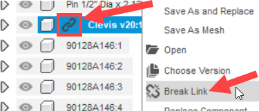

Hi @edwin.martinezVUUNS
Thanks for the post. Note this forum in English only, so I translated your post.
A .f3z file has component(s) that are insert/referenced into the Fusion assembly file. To change the file to a .f3d file (all components are local), right-click on the referenced component (shown with a link symbol) and click Break Link.
Hope this answers your question.
-Dan
