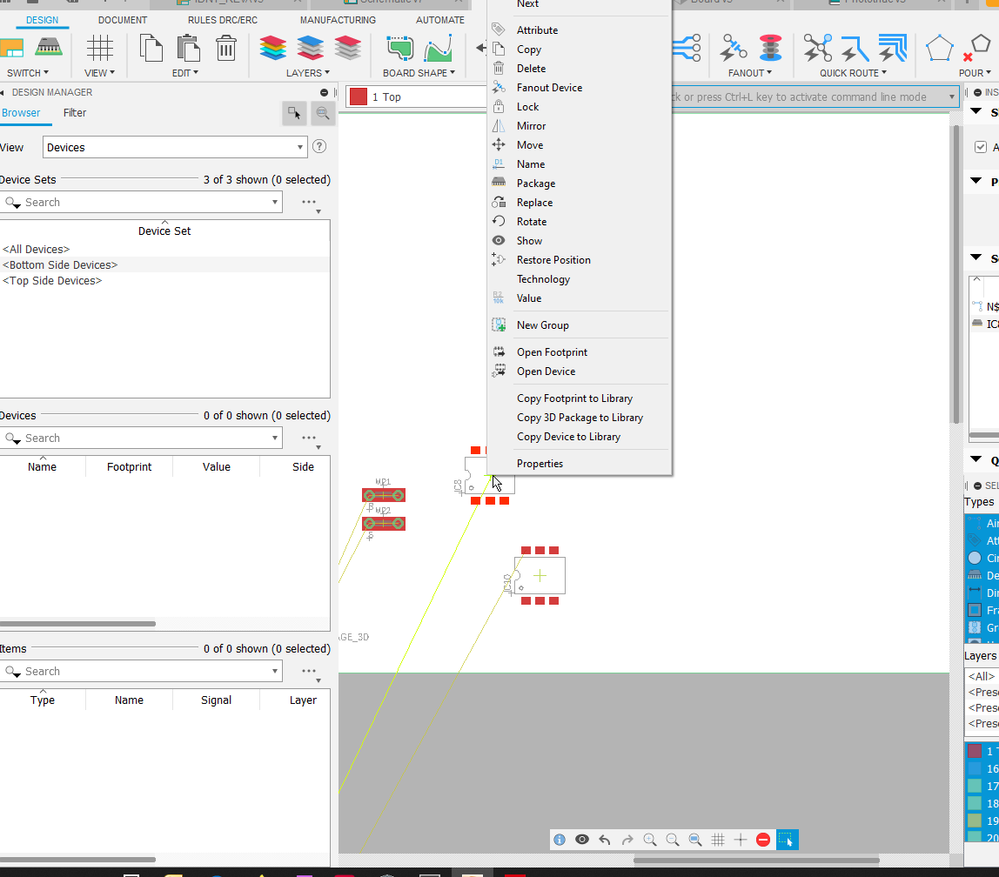

Hi @engineeringNCMXB
Thanks for your answer
But it duplicates the symbol in the same library, isn't it? I would want to copy footprints/symbols/devices to another library.
I would like to copy footprints from library ref-packages-3d.lbr to my custom library.
Best regards
I have found the way to copy a footprint/symbol/device to another library.
1.- Open the destination library.
2.-Add to your schematic/board the device you want to copy.
3.- Right button and "copy footprint to library".
Best regards

Excellent, thanks for sharing. Hopefully we will see the ability to copy from library to library directly soon. This is a good workaround until then.
