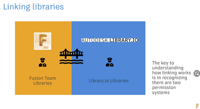

After a one-on-one conversation with @jorge_garcia at Autodesk, I got the answer to this one.
First: Watch the video I linked above.
As a user coming from the original stand-alone Eagle, my part libraries were established as 'managed' libraries which means they are stored and managed in a cloud system called library.io. In general, the users do not interact directly with library.io although you can login to it and see you libraries. The only thing most people need to know is that is the system that holds library data that needs to be broadly shared or used with Eagle.
Fusion360 has it's own library system as well which is wholly independent of the library.io sytem or Eagle local libraries. When an F360 user needs access to an exisiting library that exists on library.io, they can open it up and look at it......but when you save it you have now created a Fusion library. The Fusion library is a copy of the original.
At this point, you have two libraries like what I showed in the original post. They need to be 'linked' so that as you make changes and additions - the two seperate libraries always have the same data. There are some pitfalls here that I am still trying to undersand but I am making progress in my understanding while simultaneously pushing for a system that is far more intuitive. It should not require this my work.

Yes you can export a Fusion library from  inside Fusion. It creates an *.flbr file.
This file can be used with Fusion, but not in Eagle.
If you save a managed library from within Eagle - you get an *.lbr file that can be used in Eagle OR Fusion360.
The most hacker-style method that I know of is to log into your library.io account in a browser.
Get the 'urn' number from either Eagle or Fusion360 of the library of interest.....
Use this URL command to download the version of your choice:
https://contapi.circuits.io/123D-Circuits/libraries/ASSETID/export?type=eagle&datamodel_version=9.6.3&version=xx
Change 'ASSETID' to the 'urn' number.
Change 'xx' to the version number you need.
press <enter>
It will return the *.lbr file of the specified version.
This is how I recovered my damaged library.
