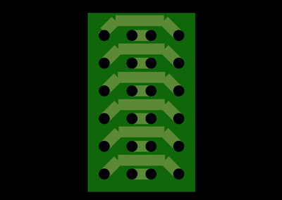

I found another 2 problems.
First with generating gerber files. I made a very simple adapter.
the preview of the generated gerber file looks like this:
next gerver viewer:
another problem concerns the 3D preview, it looks like this:

jorge_garcia
Hello @Anonymous,
I hope you're doing well. What gerber viewers did you use? Something looks definitely off there. I'll ping the developers on this for review.

Message 9 of 11
I use gerbv, it never let me down, the second picture is from the preview at jlcpcb.com. I noticed that sometimes when I restart the program (fusion) the problem disappears, but not always.

jorge_garcia
Hi @Anonymous,
I hope you're doing well. I don't trust the jlcpcb.com preview at all, I've had to deal with a lot of issues with them. I've worked with gerbv a lot and even though it's lead me astray a couple of times, it's very solid and I do trust it.
Would you be able to share the gerbers for review?

ampio
I was able to call this error again, in the attachment I send incorrectly generated gerber files.
