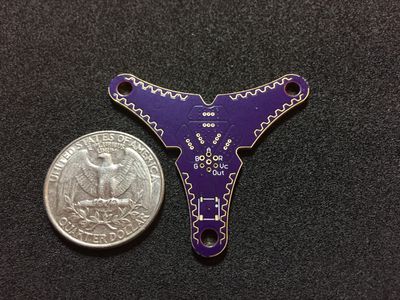

I am not sure a constraint base sketch approach needs to be extended to "everything".
Below is an image of a very challenging PCB. At least it was very challenging 6 years back.
It was challenging, because no "reasonably priced" software provided what I needed.
Creating the board outline in Eagle would have been an absolute Nightmare. So I exported the sketches I created in Fusion 360 into a DXF files. The semi hexagonal footprints for the LEDs  were non standard and very specific to this particular board, and so was the routing.
I then used Altium Circuitmaker to create the PCBs for that project. The reason I used CM is because there I was able to turn imported DXF lines/curves into traces. For some of the PTH pads I needed the ability of having a  different sized annular ring on the top and bottom side.
The "square-wave traces on the three arms are purely decorative. Once I knew that I can convert imported dxf geometry into traces   this was easy to do.
I have not tried this lately, but I believe today I can easily sketch the and model board outline in Fusion 360, without the need to export/import DXF or any other file format. What I cannot do is to convert sketch lines/curves into traces.
When I can design that board in Fusion 360 without obscure workarounds I think the necessary functionality has been implemented.
