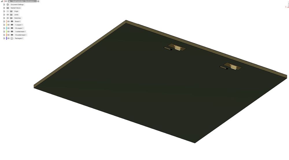

Hi, I have following problem:
I have footprint with non-standard hole SMD-PAD + Milling
footprint-smd-millingfootprint-smd-milling
when I put the part on schematic and on pcb everything is ok, I can move the part and on cam preview milled holes moved with the part, but when I create 3d model of pcb and move the part old milled part not moved and they stay on the model. How to solve this issue ?

Hi @anastasov.rosen ,
I hope you're doing well. From the 2D PCB go ahead and click Push to 3D PCB, it should update the locations of those holes. Can you confirm if that works for you?

Hi @jorge_garcia ,
I do that all the times but without success (I mean all type of combination push to 3D and push to 3D with option).
When I move the part 3th time milled holes from 1st placement are disappeared and new ones from 2nd one are on the 3D model.

Hi @anastasov.rosen
I hope you are doing well!
For the milling layer, it is a known issue and has been reported to the develop team.
I will keep you updated when we fix this issue.
